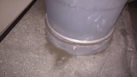

Also noticed a bit of creosote also came out of the chimney on top of the stove somehow, is this normal? No smoke/smell issues after we got it all cleaned up and lit a fire last night though.

That exterior soot came down from somewhere. Single wall pipe doesn't fit together that tightly but usually it is assembled so that any falling debris is channeled into the pipe. Is your pipe installed upside down?

Ahhh, well then I'm sure a bit probably escaped when it was swaying back and forth a good 6+ inches - I didn't notice it at first and the drill was so loud I couldn't hear my wife trying to warn me for a minute. It doesn't look upside down to me but I'm not really sure what I'm looking at either. The sections do all have stickers at the top of each section that seemed burnt up (should have been removed probably by the previous owners when they put it in in 1999 maybe? oopsies!)
We could brace it pretty easily to that band of wood basically where the 2nd floor should be, if the brace wouldn't spread the heat over to that wood too much.
