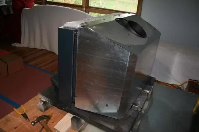

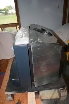

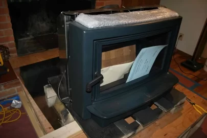

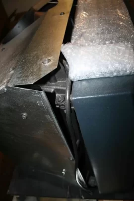

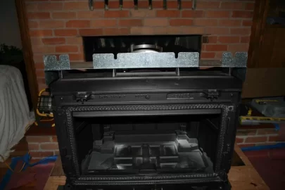

Does anyone have a link or photos to be able to view the back and sides of this (Clydesdale 8491) unit? The schematic is lacking somewhat. Thanks.
Jones:
Please see the attached photos, they might help. I installed my unit in a masonry fireplace having a masonry chimney and clearance to combustibles was not an issue. Regarding installing your unit in a ZC factory fireplace, you might want to check with a certified sweep, dealer (a knowledgeable individual, whomever that might be) to ensure that you have adequate clearance to combustibles. The Clydesdale Owner's Manual says this:
"You can install the Clydesdale in masonry or zero clearance fireplaces. Before installing the stove in a factory-built fireplace, the fireplace must have the following characteristics..." The Manual then lists eight (8) conditions that must be met first before the installation. The Owner's Manual can be downloaded from the Hearthstone site.

Thanks for the photos, visuals are always helpful. My ZC fireplace opening measurements are 45.5" wide x 32.5" high x 23" deep, so I think the proper clearances are there? I reread the manual and seems as if we are good to go. I will post progress on installation. (Wish we had masonry, but you have to work with what you have).

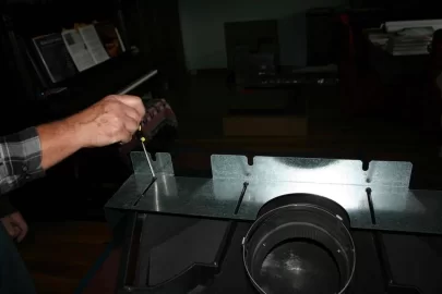

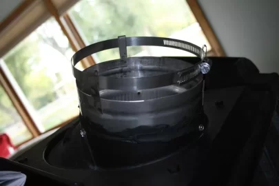

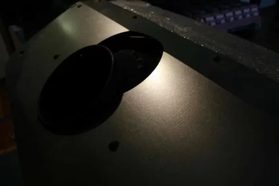

Jones:
Here are three other photos of the back, side and top of the Clydesdale. Just found them in my collection of Clydesdale install photos.
Good luck with your install.
