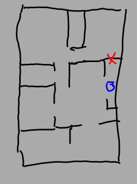

    I am thinking about adding a wall vent in between a bedroom and living room (where the wood stove is). My thoughts were that it would help with the bedroom temps and cut down on the cool draft from the hallway. I have done the fan trick and find it makes the master bedroom to warm without much improvement to the second. And makes it chilly sitting on the sofa.
    Questions:
    1: Is there any safety concerns?
    2: Will it work?
    I am attaching a sketch I have done on my phone , forgive me for its sloppiness. If a better diagram is needed I can make one up tonight. The blue circle is where the stove is and the red X is the proposed vent location.
    Thanks, Mark

    Are you talking about a strictly passive vent or an in the wall fan? I have an in wall fan (Home Depot online around 75 bucks)that is 2 speed and hard wired. It forces a draft between the room where my stove is and an attached greenhouse. My experience was I got very little draft without the fan - even with the temperature difference between a high 70s stove room and the 55 deg greenhouse through a partially open window. Will a passive vent make a difference in your setting? Somewhat. Will it give you a significant boost in temps? Not based on my experience.
    So far as safety .....the general rule seems to be that you want to blow the cooler air towards the stove room not the warm air into the cool.

    I would consider putting in a wall fan on the stove side (high) and use the stud cavity as a plenum, then put the return grille (low) on the bedroom side. That should set up a nice convection loop by blowing the cool air toward the stove. It will be replaced by warm air via the hallway as long as the bedroom door is open or at least has a gap at the bottom. There are fans made just for this purpose.

    Code does not permit a return air vent to be less than 10ft away from the stove. However, a supply (delivering cold air from the adjacent room) is not under any restriction.
