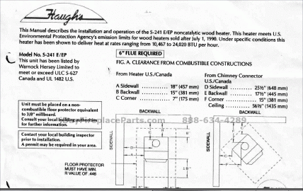

    Hi BB,
    The original document from Haugh shows the output maxes at 24,000 btu/hr. The Century Heating CB00011 shows 40,000 btu/hr. Has the stove changed? BTUs gotten smaller? Or has the sales department taken over the testing function?

    We will never know. Those numbers come from somebody standing in front of it feeding it like a locomotive firebox.

    I think the original 24,000 BTUs sounded reasonable. There has definitely been some marketing BTU inflation in the industry.
