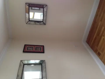

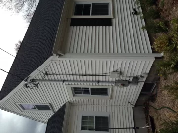

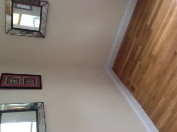

    Hi guys,
    I have this corner for a future harman stove install. Question is the venting. I need your feedback. Thank you.
    There is an electricity meter on one side and an oil pipe to the basement on the other side by a window.
    A) straight out
    B) up 4 feet and out
    C) roof exit
    See pictures

    Facing corner ,with the stove at a 45 deg. angle. I would put the "OAK" out the right wall. And the exhaust out the left wall. Running the exhaust out to clear the outside wall about 12 inches to a clean out tee than up about 6 to 8 feet to termination cap .
