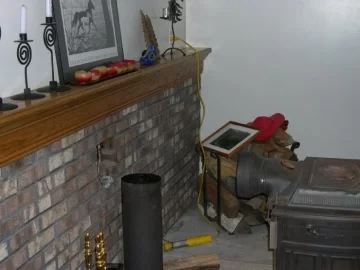

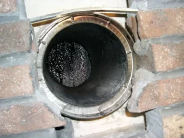

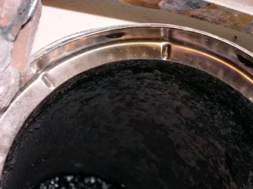

As near as I can tell, the current wall penetration is an 8" Class A pipe - 8" ID and 10" OD. Seems the easiest solution will be to open up the wall a bit, install a thimble around that, extend the Class A into the room, and on to connect with the stove.
First off, how do I figure out what brand of Class A pipe I have now, or does that even matter?
For the thimble, given my spacing inside the wall, I'm thinking something like the DuraPlus 9243N (the 9643 back plate dimensions just don't quite work out). However, my wall thickness is about 9". The 9243 says it's for up to 7-3/4" walls without a field-fabricated extension. In my case I see no need for the extension, as there are no combustibles within 4" or so in the wall. Sound ok?
Coming out from the thimble, I'd use something like a 9" section of DuraPlus Class A in black. That would get me out 4" past the wall, and the end of the Class A would be 6" away from the wood trim on the mantle. From that, I need a finishing collar, an adapter, and 15" of double wall pipe - for that something adjustable would be best for me - perhaps the Metal-Fab 8DWB18A. From that I would just need to connect to the stove - perhaps something like the Metalbest DSP8FSA 8" Flush Stove Adapter.
