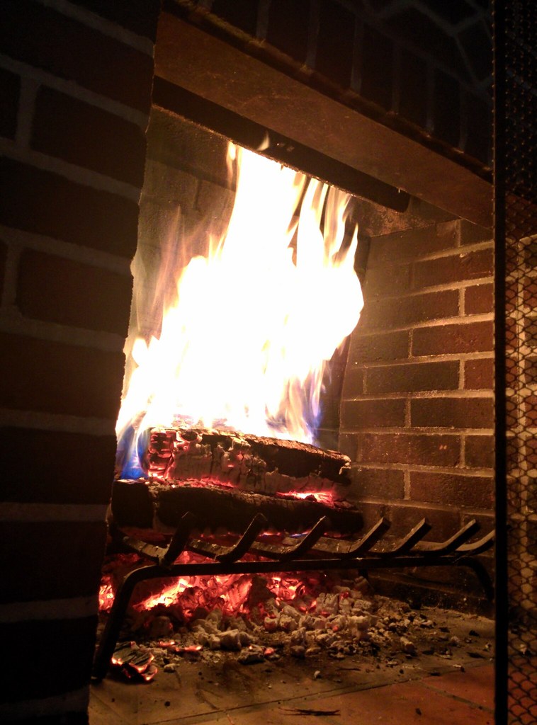

Started small to warm things up, after 6-7 hours it peaked at this:
Cracked brick in old 1930's brick fireplace :(
No issues with a fire this size? Don't want to go any bigger... but want to be safe. Never had a fireplace before...
That's not going to hurt anything. I know you get lots of radiant heat out of that when it's roaring...and ambiance & whatnot. Something to consider, though, is the fact that a masonry fireplace & chimney like you've got there is a very inefficient woodburning appliance. Most of the heat from the fire goes right up the flue to daylight, along with a whole lot of warm air from the living space. There are alternatives to burning wood that way. We know all about them here. If you're interested, stick around, ask questions, do searches. A woodburning insert might be just the ticket for you. Welcome to the forums! Rick

I'll definitely stick around. It's an older apartment-style building, so there is steam heat but sometimes the heat can go out or sometimes a few extra degrees can make the difference of being comfortable to downright chilly when the temps really go down.
I really appreciate the help - given this is a shared building I feel like it's only responsible to take precaution when burning.
