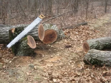

Lance tooth saws will cut dry oak just fine, but the hardness of the wood makes single bucking slow with a small saw. If you have a helper, you can cut through any wood much faster. When cutting pine, have a can of WD-40 or Orange Blast handy to dissolve the pitch.
This was posted on another forum, but it's a lance tooth saw in a red oak:
