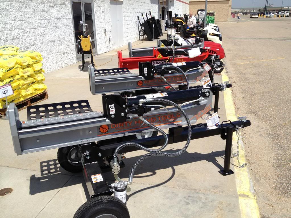

    Has anyone seen the new 27 ton DHT log splitter? It is available at selected TSC stores and some other retailers.
  2. mikefrommaine
    mikefrommaine
    Guest 2.
    Doesn't look particularly ground breaking to me. Filter is in a stupid spot.
    [​IMG]
  3. MasterMech
    MasterMech
    Guest 2.
    That's where a lot of them are.
    [​IMG]
    Where would you put it?

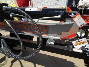

    Can the filter handle being sideways when the splitter is being used vertically?
    If so I'd mount it to the beam. Would require an extra hose and fittings but it would be out of harms way. There has got to be a better way than where it is mounted. It wouldn't last long on my trails down that low.

    On mine at least, the filter is nowhere near the lowest point, the frame/tank hangs a few inches below he bottom of the filter. Mine has survived many highway tows but I generally don't take it into the woods. I'm usually under the gun to get the wood out, so I usually haul rounds back to a central processing location.

    im no expert on splitters....i don't even own one.....though i wish i did....cuz it would help me a whole lot.....anyway, looking at that splitter, isn't the filter there so you can tilt the thing up and split vertically as well?...then the filter remains stationary doing its job properly?
  10. nate379
    nate379
    Guest 2.
    The filter can be in whatever direction, vertical, horizontal, threaded end up or down, it doesn't matter.
