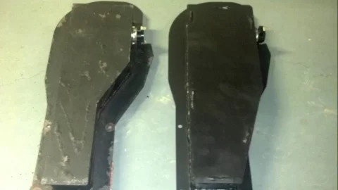

He informed me of a couple different updates. First was a higher flowing exhaust manifold, second was a new sail switch (on back of OAK, it opened sideways instead of up and down, which provided more flow. I ordered both the new high flow products and also a new combustion blower, along with several gaskets for the rebuild and some for the shelf.

Just a new blower and I would have been in business. But the sail switch and manifold helped tremendously. Yeah it was a couple hundred total, but being able to talk to "The Man" about these furnaces, gave me so much insight as to what to expect. After sending him pics and explaining everything in detail, he said it was a Textbook install and most everything but my Plenum coming off the unit was ideal (He said 45°'s would be best, but 90°'s are all I had).
