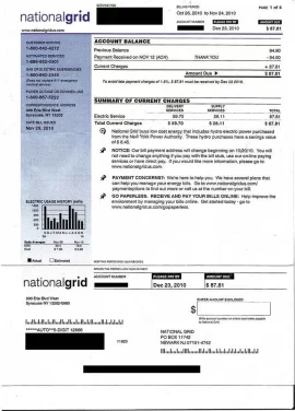

Whatever it is, something changed. Either I had the baffle plate wrong (I'll never know for sure) or I'm just getting to know the stove better. My strong suspicion is the former is true. I waited until now to report this, because I wanted to get a better read on things as the weather got colder and the stove and chimney got to winter conditions. When I noticed that wood was disappearing from the wood piles at a much slower rate than last year, I figured that something must be radically different or I'm just getting really, really good at running this stove. Last year I had used a bit more than a cord by this time, but I didn't start burning in earnest until December. This year I started much earlier than I ever have, with once-a-day fires beginning in mid-October. The result of that decision is demonstrated in the scan of my power bill below. The wood piles shrank by about the same amount by Christmas in both years. And the November electric usage? About 1/3 of last year's usage, saving me the cost of the entire cord of wood, plus a 12-pack of Sierra Nevada Pale Ale.
