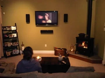

Picture is before i do drystack stone vaneer wall behind stove. I will post and updated pic when i finish.

How in earth did you ever get away with that hearth pad? Doesn't your code require 18" out from the opening? You've got like 4" from the door to the carpet.

Looks great! I had the same question about the hearth pad though.

Hearth pad is inadequate.
I'm also wondering if that is single wall pipe with the flue thermometer on it? Is it is, it needs 18" from the wall minimum and bumps the stove clearances out to 13" from the corner.
