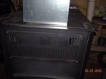

    One thing I just noticed? The front cover is missing? For your convection blower area?
    Isn't there a cover to allow more air to go up the duct and less emitted out the front?
    Just wondering? The upstairs will get more flow, if you block off some of the downstairs air.

    I noticed the same. It looks like the blocking plate is installed behind the grate instead of in front.

    I don't actually want heat in my basement, I would want it all upstairs. I wonder if you could block it off completely?
    My install is all convection heat in the duct work, I get enough heat with the stove not having return air. The air returns down my basement hall way through the louvered basement door. Basement stays plenty warm enough with what heat returns and the radiant from the stove.

    I agree. The radiant and return air should be more than enough.
    Put all that heat upstairs where it's really needed and the rest will follow (back downstairs and keep the basement comfortable) :)

    You could block it off completely. I believe SBI leaves that small gap in case the duct was to be blocked you would have an escape for the hot air. In my set up I would say 70% of the air goes out duct and 30% out the front

    FyreBug - can you comment on this, please? I've considered blocking the front opening off completely too, but figured it was designed that way for a reason. Sending all of the air up through the ducts would, howdver, be nice. Thanks.

    DSCN0278.JPG I mounted blocking plate that came with the accessory kit to back of grill, now I use a piece of magnate sign I cut 12in long 3in High to block off part of bottom plate witch I remove If I need a little more heat in cellar. See picture

    Fyrebug instructed me that approval was made based on having some air escaping the front in case one
    of the duct would be blocked as DV mentioned in the above post.....
