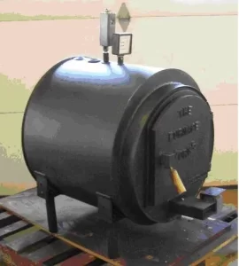

The boiler pictured below is like our first boiler much like a outdoor unit ,less insulation and the metal roof.
