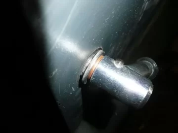

    I measured the new silicone gasket that I bought 1 year ago but never installed.
    It measures approx.55" long and 1-1/8" diameter.
    The biggest problem with my door seal was the door didn't close far enough even after adjusting the hinges in.
    After a period of time the gasket gets a seat formed in it from the door frame,but there is really nothing wrong with the gasket.
    I noticed that there was some play for and aft in the door latching handle,and it looked like if this play was eliminated in the right direction it would let the handle pull the door closed tighter.
    So what I did was to wrap a piece of bare 12 ga. copper wire around the door handle shaft between the handle and washer and twisted it tight and cut off the excess.
    It worked perfectly and after some use the copper flattened down nicely.
    I know it sounds kinda like a cobble job but it has been working like this for over a year with still the original gasket and no leaks.
    I do keep the handle moving parts lubed with white grease.
