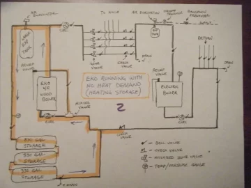

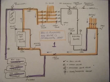

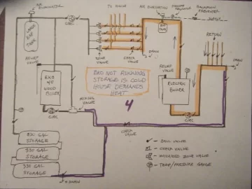

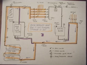

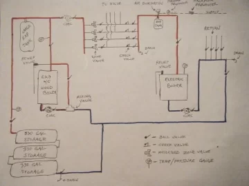

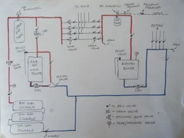

burn baby 2010 said:Yes, my intentions were to have the electric boiler run all 4 zones equally as the system is originally installed. Yes to the second question as well. Do I need to put the circ before the tee going to the tanks on the return line?
