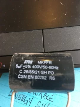

I was out cleaning my boiler today and when I started it back up, I noticed the draft blower was not working. I assume the capacitor is bad in it. Once I spin it by hand, it will run, but not as fast as it should. I can not find an exact match for the MKSP-5P on-line. I did find this product at amazon:
AC 450V 4.5uF Ceiling Fan Motor Running Capacitor
Part Number a12070300ux0518
Will this work for my situation?

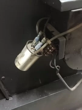

This is the spare for my EKO 40. I took this one into a shop that rebuild electric motors and they gave me one with similar specs. It worked but wasnt smal enough to fit in space provided for it.
EKO Biomass Fan Question
I looked for that on-line and couldn't find it. I found several EN60252 but none that I see that are close to those specs.
I just looked at the link and he's charging $12 for it. I found one on Amazon for $2.76. It looks to me like it's the same thing.

I will try this first and see how it goes.

I doubt it will fit too. I'll just tape it in place. The plastic housing is busted and I've taped it together. As long as it does the job, I'll be happy with it.

Is this a start or run capacitor? I assumed it was a run capacitor because of the low uF.
I would say its a run capacitor...
Funny, that's one of the videos I watched last week. I figure the motor's gone bad. I contacted Zenon and he said it was too old to be covered under warranty. I told him I thought the warranty was for 5 years and I'm still under 4 years, but I still haven't heard back. If he won't replace it I'll start looking at the starting winding.
