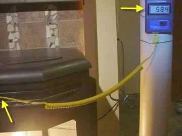

    Most stoves I have tested with my very accurate Cole Palmer Digital tester and special High Temperature probe put out approx 200 Deg F on high. The Avalon Astoria I purchased puts out 600 Deg F on high! (Heat level 6)
    BTW: My basement install does heat the whole 2,000 sqft house down to -6 Deg F
    I do have a finished basement (No insulation in ceiling) and 2 registers in the kitchen and living room that feed 200 Deg F heat from the stove below.
    See Thermometer and yellow arrow in pic below. It shows current heat output of 584 Degrees F
    Click on pic to enlarge
