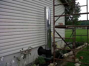

    This was my 1st yr burning in a woodstove (have a Pre-Fab upstairs) and I have 18 ft of Triple wall Simpson outside.
    Works great.... Good draft and easy to clean.
    As others stated. Wrap it with a chase if needed (looks and some insulation) but not needed. I like the look of my Class A going up the side...
    That Progress is a beautiful stove. Should serve you well ;) 2011-10-06_18-23-02_484.jpg

    What carries the weight on that setup, the roof brackets?
  21. begreen Super Moderator
    joined: Nov 18, 2005
    36,433 posts
    South Puget Sound, WA
    Had the same question. The tee support bracket appears to be missing.
  22. DexterDay Minister of Fire
    joined: Dec 11, 2010
    9,159 posts
    NE Ohio
    The T support is there. Hidden by plantlife. Tap-cons holding it into the block. Had to dig a little out from under it and laid down some pavers. Not to bad to get to the clean out cap.
    Still hard to see here. But this pic is from install.

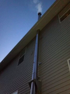

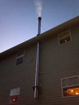

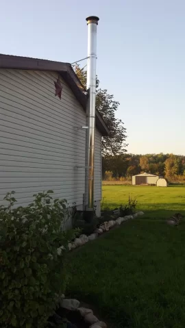

    We have around 4 feet of vertical single wall in the house, and 18 feet of stainless Class A outside. We live at the foot of a large open field that is more-or-less at the foot of the mountain, and we have no overdraft issues whatsoever. I think you have about the ideal height on your setup, you should be fine. Worst case scenario, if you have an overdraft issue, you could always get a damper......
    2012-09-22_17-00-34_0.jpg 2012-01-15_17-35-11_15.jpg 2012-01-15_17-34-57_213.jpg
    Backwoods Savage and DexterDay like this.
