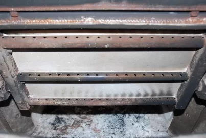

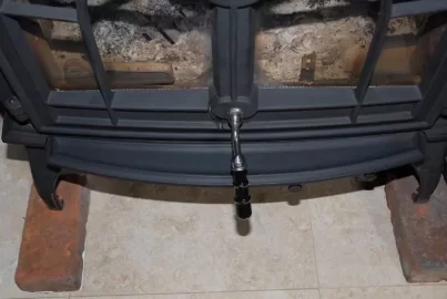

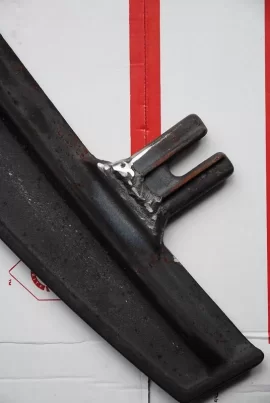

Well, I got the 1/2" baffle board from ebay (https://www.hearth.com/econtent/index.php/forums/viewthread/79790/), the welder did a great job on the broken ash lip, and I found the steel I needed to make a replacement burn tube--so the black beast was all ready to fire up!
To be honest, I really wasn't expecting much--it's only 51 outside right now and raining--so lousy conditions for a good draft and the inside of the stove was totally cleaned of all ashes from moving it, so other than dry wood pretty bad conditions for a test fire.
But I'll be damned if she didn't burn just great
Built a top-down fire, shut the doors, opened up the primary and start-up air, and she took off like a rocket! I'm very, very impressed and happy---THIS is how a wood stove is supposed to work as opposed to our Oslo that always felt starved for air and was very sluggish from a cold start--even with either the side or front door cracked open for a good 10-15 mins.
So, $50 for enough baffle material to make 4 baffles, $8 for 306 SS tube, and $32 to repair the ash lip, and we're good to go!
If she burns this good under these very marginal conditions, she ought to burn just great once Winter hits. I'll post some pics tomorrow of the repairs---'cause we all know no pics=it didn't happen! lol
