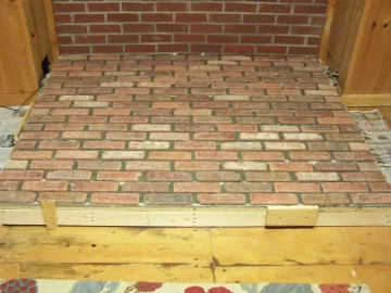

    Great job on the hearth pad. I'm building my first one as well for my Fireview. Just staining the wood siding, going to apply that, blue tape on the top edge and start grouting the joints. That way I can bring my mortar right to the board. I used thin used red brick. Nothing fancy, back wall is brick. Wife just wanted a plane square pad because the house is old. So that's what I built. 000_0272.JPG

    Looks great charly! I might get the rest of mine finished up next weekend, looks like some mild weather this up coming week so I won't be burning much.

    One thing for sure, it makes me appreciate how nice other peoples heart builds are. I dread dragging the stove onto the stones. Have to be careful. Think I will use leg slides and some small sheets of plywood, until she's in place , then lift one side of the stove at a time and remove everything. Actually will carry or lift the stove, inch by inch. Hope the wife is feeling strong. Her and I got the Quad 5700 out ourselves. Just have to work smart. Going to strip down the fireview, top and door off and remove the firebrick. I guess I really appreciate it all once my break in fires are done. I want to do them right, because I think I'm going to love this stove. Everyone else does;lol.

    Yeah, it wasn't fun moving the hearth and stove, the hearth is probably 350~400 lbs. and the fireview is 485 lbs. We had 4 of us moving it, i got the hearth into the house and rolled it into place with a furniture dolly, then did the same with the stove. Picked it straight up and onto the dolly and rolled it into place. The wheels on the dolly did make some marks on my hardwood floors so kee that in mind if you choose that option. Judging by your picture, it looks like you have wide plank pine floors.

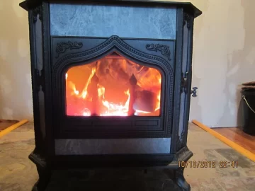

    As far as the break in fires go, make sure your first two fires are low. My first one was just kindling, let it burn out, the second fire was kindling and a small split. On the second fire I could here some sizzling in the corner where the soap stone and cast iron meet, sounded like the cement curing. At that point I went out for a couple hours and let the stove completely cool before I lit the final break in fire. The third fire I engaged the cat @ 250 degrees and let it rip. I kept the fire going all night and most of today, didn't hear any more air noise and all the paint and cement cured. The house smelled pretty bad for most of the night but the smell is pretty much gone now.
    Here's a pic with the cat engaged, stove top temps @450 degrees.

    Handsome stove! Great fire! You're going to love the stove...

    Yes those are old wide plank floors. House is 1840. One half of the room has 8 inch broads and the other half has boards going the opposite way, those being 14 inch wide boards. One person believed they could be walnut. I know they are very hard and don't scratch easy. I wheeled my Quad 5700 off the other hearth and out of the room down a very shallow ramp and out the back door to my tractor with pallet forks. The fireview came in the same way.Floor seemed OK as far as marking it up. I did shim the other stove up with blocking until it was off the ground and the dolly was now holding it. Why I had the fireview pallet in the air , I built a bottom underneath so I could set it on a dolly. I'll just take my time moving it. I want nothing scratched or broken. Looks like some windows will have some fans in for the break in fires.
