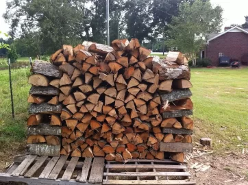

OK, I finally got around to posting pics of my first attempt at boxing the ends of one row.

Cool...no t-posts required

looks like a beautiful place you have there mudbug.
Not too bad with what you have to work with. You really need longer pieces especially for the bottom sections. The longer and thinner the more stable it will be. It also helps if the are similar size.

gzecc..yeah I had already cut the wood to my 16" lengths before I knew I would be boxing the ends. I just tried to ere on the ends leaning in towards to the row instead of leaning out.
onetrack.....Thanks. yeah I like the place pretty well. We have a 2600 sq. foot single story house on a 7 acre lot, with about 4 of those acres being lawn. The house was built in 2004 and added on to in 2011 after we had our twins. 4 kids total. Then our families have probably 750 acres that we have access to. We are blessed!
Square pieces from the middle of bigger rounds are best. Nice, straight 8"ish rounds split in half are my second choice. And don't stack so that there is much leaning on the cross stacks. To me, they should just finish off a stack. I can remove my cross stacks, and only have a few splits fall to the ground.

Off the ground, in a sunny area with good air flow. Perfect!

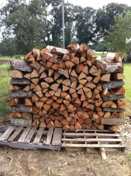

View attachment 72714View attachment 72715
Looks real good ! When I first started doing it , I thought it was a major PIA. But now, I won't consider doing it any other way .

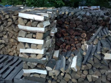

Looks good to me. After getting used to building them, you will know what pieces to pick out of your pile for your ends when you are stacking. When splitting my wood at home, I make a habit out of taking the really big rounds and splitting them into "square" splits, and I toss those splits to a side pile when splitting. I use those square splits (along with others) to make my crosshatched stack ends. Makes it easy as pie, and they are very sturdy. I've never had one collapse yet (knocks on wood). Here's some pics of a big norway maple I C/S/S-ed a couple months ago....

Those ends look fine to me, too. Ya done good. +2 on the ideas to reserve the half-rounds and square splits for the towers.

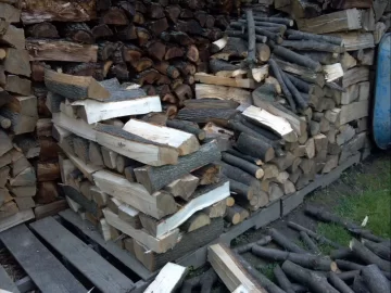

Mudbug, that is good for your first attempt. Congratulations on that. You no doubt will learn much from this first stack. One of the biggest is what pieces to choose for the ends. For example, look at the first picture on the right hand side. The first two layers give you a big hint as to what is going to happen, and it did. Notice that the end of the second layer is way far out from where the first layer is. Now notice that very bottom layer. Look closely at the two splits you used and you will see they are not laying flat. They have rolled a bit (and this also caused some of that problem with the second layer). Look also at the 9th layer and you will see one of the splits has tried to roll.

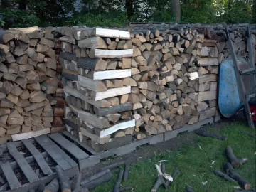

As Scott stated, choosing the right pieces for the ends will really be the biggest thing you can do for the stacking. A lot of my ends are built using square or rectangular splits (see picture below). Like Scott, when splitting and I get a nice piece that will be used for the ends, I throw those into their own pile. Then as I'm building the stacks, I build the ends at the same time as the rest of the stack. Some will build the entire ends before filling in the center but I like to do it level all the way up.
