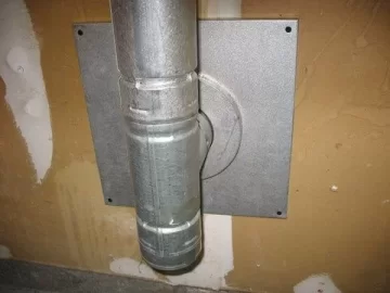

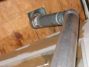

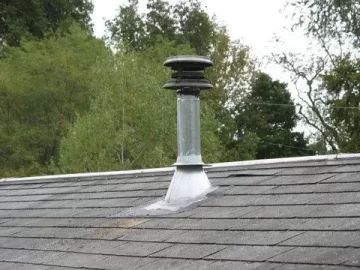

That is not nessaraly true i ran my exhaust pipe into the garage then straight up trough the roof i did this after i checked with the pipe and stove manufacture who said that it is exceptable as long as you follow the install instructions and maintain all clearenses just make sure to seal all your pipe connections
I second what panhandler says NO OPEN FLAME, DURA-VENT DOUBLE WALL INSULATED PIPE you can put your hand on it and keep it there, just follow the pipe manufactures installation instructions. if you need pics just pm me and i will send pics of my install
here is the install i did
Which is precisely why I said check with the installation manual and code enforcement.
My install is exactly what you propose. A professional Harman dealer did it though so I assume he knew the code. Pipe is hot to the touch for several feet. I live in a rural township with pretty lax building code enforcement-based on what I've seen. Dealer used pellet vent pro with thimbles. Wouldn't take but a half day to reroute if necessary. Kinda gives the appearance from the outside that the STOVE is in the garage though-which it isn't.
