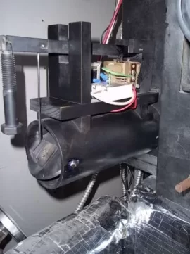

I added an inlet draft damper that maintains constant flue temperature by adjusting air inlet.
But whether automated or not I think re-designing the inlet damper to be adjustable all the way down to completely shut off would be a good modification. With storage it makes no sense to me to have draft controlled by supply temperature, I think it makes more sense to be able to set the draft at a fixed opening once the unit is running steady.

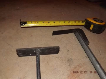

I like your tools. That is one annoyance of mine, that the ash that collects alongside the refractory is difficult at best to clean out without removal. I wonder why they don't provide such a tool with the boiler to begin with. I've thought of making something like that, just wasn't sure how much it affected the performance, but based on your work it appears to be significant. I have begun to clean more often, but you make a good case for a quick scrape before each burn.
Not sure I fully understand what you're saying, but with a forced fan draft already, I'm not sure how much difference this makes.
I couldn't seem to control draft very well with the factory damper flapper door. Even with the chain loose it let in more air than I wanted most of the time, and opening the flap even slightly made a huge change in air flow. So built the throttle butterfly type damper so I could adjust the air just so with repeatable measurable settings. (Then added the heat motor lever arrangement to automate draft control according to flue temperature.)
The reason I wanted to be able to shut draft off completely is to make it possible to kill the draft fan and close the inlet to stop the burn while there's plenty of charcoal left for starting the next fire. With a half a peck of charcoal all it takes to relight is to turn on the fan, rake the charcoal over the nozzle, hit the charcoal for a few seconds with a torch, pile on full size dry splits, and leave it alone.
