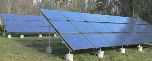

  19. begreen Super Moderator
    joined: Nov 18, 2005
    36,457 posts
    South Puget Sound, WA
    The system I saw was 5KW? in two racks, frame mounted on poured concrete piers. Here's a shot of it.
  20. pdf27 Member
    joined: Feb 14, 2012
    118 posts
    UK
    Just another note on ground mounting - you can get the orientation better (a quick look at PVWATTS for Albany and a few guesses about your roof suggests about 6% more annual generation). There are also small effects from the better cooling of the panels (close to the roof they can get very hot indeed, which reduces efficiency) and from the fact that you can actually clean dust/bird lime/snow off ground mounted panels, unlike on the roof. That might be worth as much as 10% more annual generation, which is enough to pay for a reasonably substantial frame. Looking at it, the frame could probably be made very cheaply - see http://www.builditsolarblog.com/2010/08/nice-simple-pv-panel-ground-mount.html for an example.
    Few other points to consider:
    - Solar PV can cause fairly large voltages to be generated, so you may have extra costs involved in suitable electrical insulation.
    - The panels are more vulnerable to damage from e.g. stones thrown by mowers at ground level.
    - If you're considering selling the house in the forseeable future, the potential buyers may find the roof penetrations for a solar system a turn-off. This is a bit of a theoretical risk, but a ground mounted system avoids this.
    - Watch out for the height of the trees around the septic field - if they shade substantial areas for part or all of the day, this may limit where you can site it. Same applies to the house.
    - There has been a lot of squabbling about fire risks of roof-mounted systems over in the UK (the risk essentially being that if there's a fire during the day, the firemen can't isolate the electricity to the house so easily, particularly if the fire is in the roof and so won't use water). I'm not sure if this has been resolved - or was ever a problem in the US - but that's another thing ground mounts save you the risk of.
  21. begreen Super Moderator
    36,457 posts
    Very good points pdf27. I am considering raising our rack mounted array. Weedeaters can toss small stones at high velocity too. Don't ask how I know.:(
