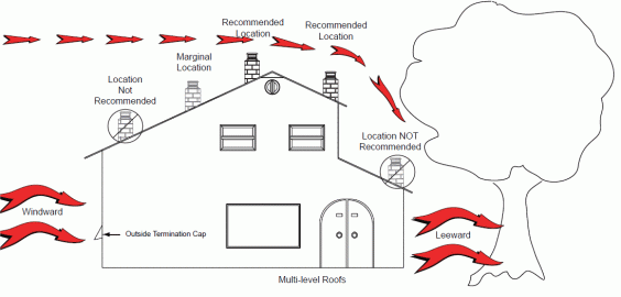

    Welcome to the forums. Something to look at:
    I would frame the pipe in a chase in the living areas. If you use 30° angle pipe for your offset there should no problem using a sooteater from the bottom up. Their site implies it can even do 45° bends easily. And yeah, like Mr. Hammers said, miss the ridge. Too much stuff going on there already...
    KaptJaq
  6. Barky McLog New Member
    joined: Jan 30, 2013
    4 posts
    Thank you for that KaptJaq, I would think that leeward would mean less pressure/more draft, and in my case leeward means northeast or away from the road, so that works out perfect also visually. Now that I think about it, prevailing wind is also AWAY from my neighbours. I can't lose!!!
