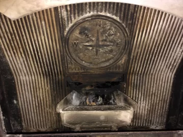

They were kind enough to let me open it up (had not been cleaned at end of last season) and inspect the combustion blower and other parts. It was dirty, but not caked on kinda dirty. Everything moved freely. Cleaned the burnt crap and carbon out of the burn pot and it fired right up. No noises from any of the fans.

Would like to restore the interior to a like new look...the medalion and rear cast panels are slightly rusted. Is it ok to wire brush them and put a new coat of stove paint on them or is there a better procedure? Or should i just clean off the crap and run it as-is and then paint the back panels next summer.....is that something that is normal to do every year if you want a "new" looking stove inside in the off season?
The lower part of the door has some crusty, kinda what looks like creosote on it, whats the best way to remove that?

My stove does not look as bad as yours, did you end up doing anything about the surface rust on the cast back panels? I know its just cosmetic, but after the season is over, I want to look at a "pretty/clean" stove on the off season.

I didn't do anything about the rust. It doesn't look as bad as the photos suggest. But, if you find a solution, I would probably try to clean it up.

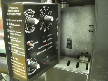

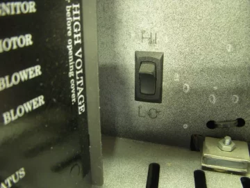

Quick question for you: Does your stove have a "hi/lo" switch behind the control panel? If so, do you know what it is for? It isn't mentioned in the manual that I have. My stove is an older version.

Edit: Just saw that you haven't picked it up yet. Maybe you could check for the switch once you get the stove.
Ill check for it when I get it, but I don't recall seeing it there when inspecting the unit.

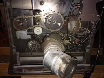

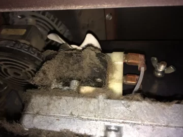

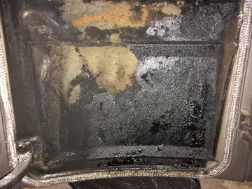

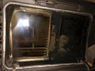

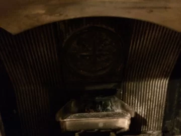

did a quick vac job of the burn chamber. Please comment on pics if you see anything I need to address besides cleaning....
Any additions or guidance to using this cleaning list?
https://www.hearth.com/talk/threads/yearly-clean-maintenance-on-harman-accentra-2.70398/
Is the crusty stuff on the door by the ash pan normal?

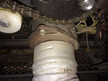

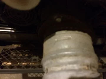

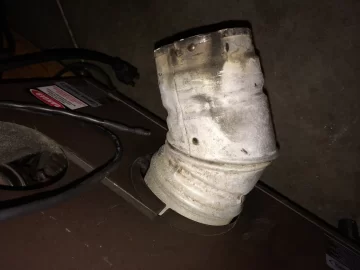

None of the venting was sealed with silicone or screws...seemed strange
Does the appliance adapter look right?
I saw a mention of a harman specific adapter for simpson.....not sure how to tell what I have....
When I fired it up before purchasing def did get smell of smoke from around venting.

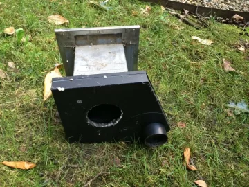

Trying to figure out what I need, installation will be a corner install which it how it was previously.
I have the harman thimble kit 1-00-677177 I'm 99% sure. Are there any more detailed instructions on installation of this kit? Its mentioned in the manual but thats it.
Also have 3ft of the simpson pelletvent and the 45. Prior had the vent sticking about 2 feet out of the wall outside...

This is the correct adapter for the Accentra stove.
http://www.ebay.com/itm/Duravent-3P...-Harman-Appliance-Adapter-BLACK-/251379978846
It fit perfectly for me.
So I am guessing by that comment the one on the stove is not the right one? Its on their tight but does not look like the one you linked to. SInce the flange on the stove is smooth, should any screws be used to secure the adapter to the flange? From there I assume the twist lock DV pipe is good, then silicone seal any joints which was specified in the manual?
Actually, I posted the reply before I had seen the photos. I'm not sure if it is the same adapter or not. To me, it doesn't look quite the same as the photo on eBay. Those indentations on the piece make it look like it is meant to twist lock onto somehting. The adapter does NOT twist lock on. I used silicon to attach it. No screws. Do you know if that venting is Simpson?

Also, does your have that "Hi/Lo" switch behind the control board? I can't figure out what that switch does!
bingo. It is simpson, but its just a standard 45 elbow based on the sticker thats still on it. Looks like I need the adapter to get a better fit. Then into the 45.
...any bets on if silicone was used =) I'm betting not...
I do have the hi/lo switch. Whats the date on your stove? Mine is may 2006. Its a little older than I thought but only has 3 winters of use on it supposedly.
I think is is a 2004. Can't check right now because it is at a different location.
Mine didn't have the adapter when I bought it. The piping was attached like yours. The fit with the adapter was MUCH better.

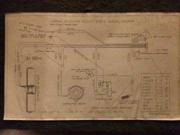

Any idea what the switch does? Do you have the manual that came with the stove? I downloaded a manual but it doesn't mention the switch.
I do have the original manual. No mention of the toggle switch.
There is a wiring diagram on the inside of the back cover so figured it should be there....it is... I attached it in case yours was missing.
The toggle switch has red/blue/lt blue wires.
The toggle switch is in the wiring diagram as "blower speed range switch" inline with the distribution blower.
Looks like it controls the distribution blower speed.
How is speed of the distribution blower controlled on newer models if this switch was eliminated...or are they fixed speed?

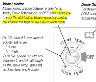

Ah, great info. Thanks. My manual says the distribution blower is controlled by the Stove Temp knob. I guess I will have to wait till it is not 85 degrees outside and fire it up! Can't wait for Winter!
harman accentra 2 - new to me what tools to use for deep cleaning
it 100% controls the distribution blower speed. In test mode you can switch from low to high with the rocker (even tho in test mode all fans run at 100%). Its directly wired to the blower so even in stove temp mode Its going to have an effect.
Thinking something like
rocker switch on low will give (low-medium) depending on where stove temp dial is set
rocker switch on high will give (medium- high) depending on where stove temp dial is set
I don't have mine installed yet so cant test the interaction with stove temp for sure.
