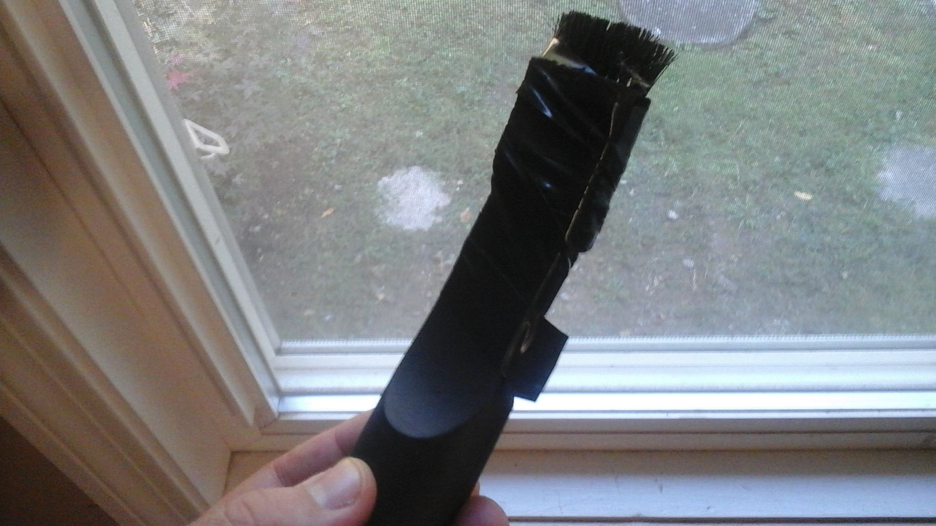

Used the smallest attachment that came with my ash vac. modified it and used a little elect. tape. Got it nice and clean. Thanks for the info.
