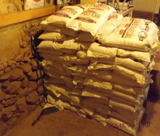

Here's enough coal to see me through to Valentine's Day, two tons, six feet from the boiler, 4'x5'x5'.
