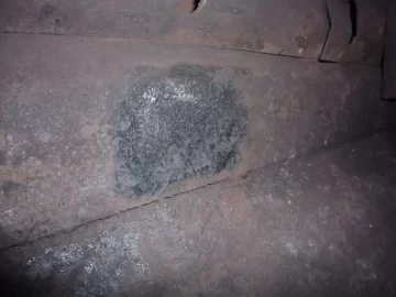

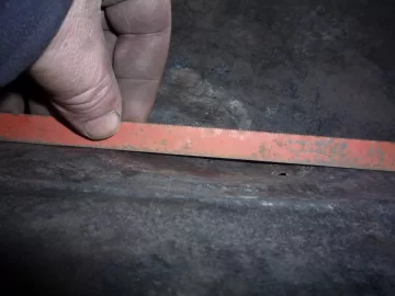

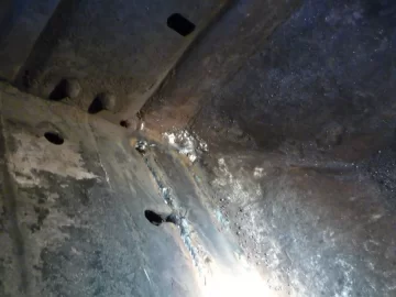

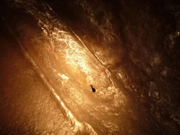

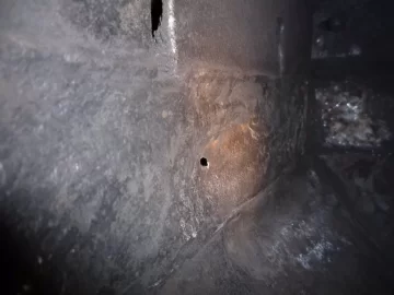

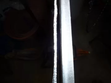

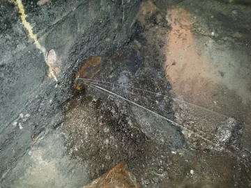

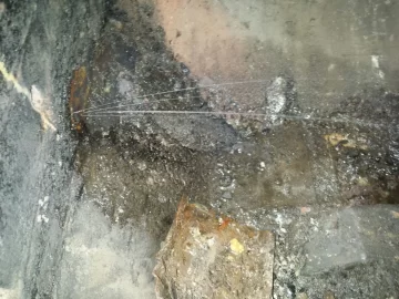

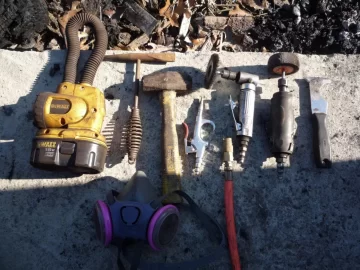

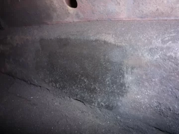

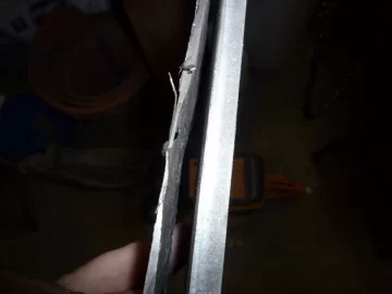

I spent 2 hours this morning cleaning other sites inside the fire box just to see if it is the whole unit or just in the front. Check the pics and you make your own assumptions.
  1. shows how deteriorated the steel plate is; I'm using a hacksaw blade for a straight edge. Definitely didn't rot through from the water side,eh?
2. You can see how the steel has almost 'worn' away in this shot
#3 Another angle of the bad steel spot
4.This is the same strip but on the right wall; looks like new! P1060449.JPG
6. The tools I used during the inquisition....

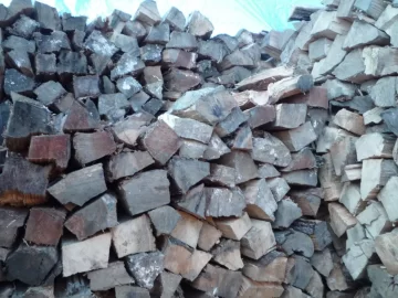

7. And this is what I feed it, all cut in the summer of 2013 in West Warren, MA, and all hardwood.
So, here we are again. I have no problems with fixing the furnace. As you all know, SHI_ happens. The problem lies in the fact that Central Boiler claims to have a 20 year warranty on this product. So far, the warranty seems to be a semi-warranty, which is only part of the problem. The service, or lack of it, is the real problem. I called my dealer, who has been very helpful. I have also called and emailed CB, only to have the service dude call my dealer back and not respond to my email. Bad business brothers....bad business. At least talk to me, I'm willing to work with them, but no such luck.

Looking at your pictures, it appears pretty cut and dried that you have some severe fire side erosion going on in that area. It didn't perforate from the back/water side.

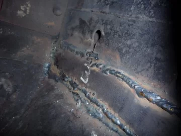

Update 2015,

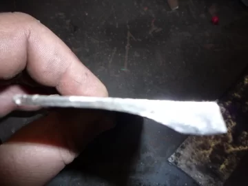

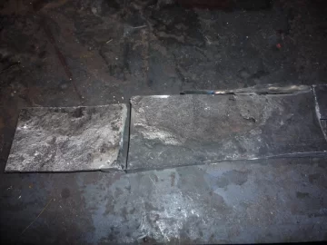

I have gotten my CB E Classic 2400 repaired. After some deep investigation which included a lot of cutting and grinding on my 1 year old wood furnace, the inadequate filler plate that had been welded into the front of the firebox, just below the door, has been removed and replaced with a much more substantial piece of steel. I estimate that CB used 1/8" flat stock to fill in the area, which is just not thick enough to withstand that constant, high heat. It has been replaced with 5/16'' flat stock, which is thicker than the rest of the furnace. No leaks as of this writing and not much in the way of satisfaction from CB, but I am yet to send of the bill. Check out the pics. Just in time too, it is supposed to be single digits if not below zero here in the next couple of days..
Left front corner with new steel..
Right side front, all patched up.
Here is what came out.....
Hows that for corroded away, eh?
On the left is what came out, on the right is what went in.....
And lastly, the spot that was leaking.....Good stuff, yes?
Thanks for watching this, I will continue to post updates about the sterling service that CB is so famous for.

If that's replaced with the same type of material (albeit thicker) - will the problem not re-occur but just take longer to get through the metal? Seems there would be some kind of fundamental flaw in the boiler design to cause it to erode like that in those particular spots.
Good luck, in any event!

I think the problem lies in the fact that the thinner material is unable to transfer the heat energy without over heating. What I mean by this is if you have ever used an acetylene torch to cut steel, you know that it is easier to cut thin stock than it is to cut thick stuff. In that same way, the thicker steel is able to transfer the heat energy to the water jacket without over heating and deteriorating like mine did. There is a happy medium though, as 1" plate would hold so much heat that it would take forever to heat the water and much of that energy would go up the pipe.
We will see what happens but at least I'm back off the Black Gold.....and on the wood....
