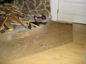

So I decided to redo my existing hearth in anticipation of my new Quad Fire 4300. On the existing wooden hearth pad, I am going to put down 2 layers of Durock which should meet Quad's vague hearth protection (r value) requirement. The problem that I have is the pad will only extend 6 inches in front of the stove....not enough. I am going to tear out several rows of hardwood flooring to meet the 16 inch requirement. Because of a nearby doorway, i cannot raise the floor in front of the "pad" above the existing grade. As such, I will only be able to put down Hardi Backer Board topped with mortar and 1 inch of stone. My stove dealer told me that r value is only an issue directly under the stove and only ember protection is needed out front. Does anyone have any experiences with this? Thanks
