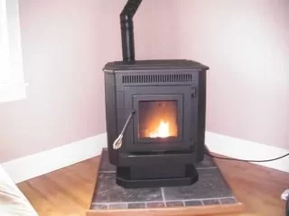

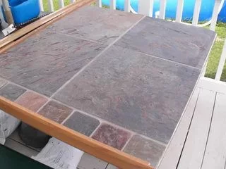

I made my own this summer 36” x 32”. Cost me around $60.00. You will need:
36” x 32” piece of plywood (had to buy the whole sheet but HD cut it for me)
same size piece of cement board (Durock-1 layer, bought the whole sheet $9.98ish and cut it myself)
4-16"x16" tiles
8-4"x4" tiles
pre mixed grout (small container)
and I used 3 long pieces of hardwood flooring for the edge.
Screw the cement board to the plywood, grout the cement board, stick the tiles to it, fill in the spaces with grout. Let dry.
Got it all at HD. Looks great! And yes it is quite heavy for me (woman, but man would have no problem).

Those are both really nice stove pads.

Nice job on the hearth Sydney!!
Nice hearthpad Sydney!
I love the slate colors- looks great with black stoves
