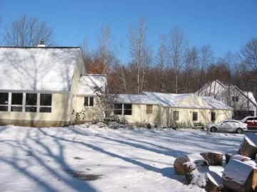

    I think my home loses heat too fast. My stove is in the part of the house to the right of the photo, in front of the cars. The part of my house that lies in between the stove and the main house, which is my dining room, is not insulated at all. It is the area in the middle of the photo, with the two double hung windows. Last night the stove room was 73 at 11 p.m., at 7 this morning it was 54, the temp the furnace is set to. At 11, the stove was loaded up and usually burns for at least 4 to 5 hours. It was around 20 outside. The dining room has no insulation in the ceiling, but does have double half-inch gypsum board (if that helps). I realize that i need to insulate that room, which i plan on doing, but does that loss sound about right? I can't be the only one with a poorly insulated home, how do the others make out? Thank you very much, for everything.

    That part of my house was at time a detached wood shop, and my current dining room was a breeze-way. The previous owners closed off the breeze way and finished up the shop. Unfortanetely the attic space in the dining room is about 20 inches high in the center, and it is 18 feet long. I would have to blow the insulation in, which isn't a problem. I'm having most of the house re-insulted as part of a remoldeling, which has been held up by an absentee plumber. I just realized the lack of insulation a few months ago. The insulation should have been done by now (just ask my wife).

    I don't know what the walls have for insulation, they are not even sheet-rocked, just paneled over the studs. I debated pulling the paneling off to see what is there, and then sheet-rocking, but that seems like a big job. I don't know what the cost/benefit would be. The floor in the dining room is slab, covered with plywood, then wood flooring. Dylan, I'm in Cheshire. I was out your way last week for a Men's game. I had a blow-out on N.Eagleville Road, I pulled onto some side road to change it and got swarmed by "the others" (Lost reference). They came out of their house, 3 of them, demanding to know what we were doing (on a public road at 6 p.m.), then told us to hurry up and get out of there. They were nice, sorta, they offered to let us use a flashlight for just $20. Are you in Storrs? Sean, your house sounds great. That must be a nice feeling, knowing that you can miss a load and not come home to a freezing house.

    Rick, heres' my 2 cents as well: those five large windows are a major source of heat loss. even double paned windows have a terrible r-value. quilted curtains for winter time would go a long way toward mitigating heat loss. Dylan yup you are just up the road from me too. I'm in Montville I just drove up to Franklin yesterday to buy a new (used) BBQ grill.

    I have a poorly insulated house. Last night at 11pm, I stocked my insert full of wood, let it burn on max for a while then turned it down to as low as it could go as the house was 75 degrees and went to bed. I woke up to the fire still going and my house at 62. Wow. Let's take a look at that little dining room. Just the ceiling. First off that double sheet-rock is R0.83 and looks to be around a 200 square foot ceiling. Let's figure out how many btu's it's losing when it's 20 outside and 70 inside.
    ((200 sq ft) * (70-20)) / R0.83 = 12,048 btu's per hour in just the ceiling that has to be replaced by your wood stove. Is that a lot though. My ceiling is 1400 sq ft and it's currently R15. My entire ceiling of my entire house is losing ((1400) * (70-20)) / R15 = 4,666 btu's per hour. Amazing huh? A tiny uninsulated 200 sq ft, double-sheet rock ceiling will lose 2.5x more heat than 1,400 sq ft ceiling insulated only to R15. Now, if these walls also aren't insulated and happen to be 200 sq ft, now you're talking a loss of around 24,000 btu's hour out that one tiny uninsulated dining room. So, not much you can do until you insulate it. My guess, your uninsulated dining room is losing more heat than the rest of your entire house. Once you insulate it, you'll cut your heating bill by probably half and worth any effort to rip out the ceiling and walls, and insulate them. You also need to air seal.
