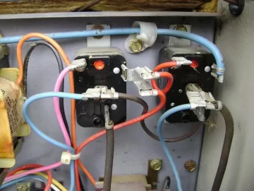

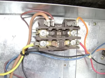

Don't **** those relays. You could get arrested for that LOL.
Seriously, this could be the problem, but do not do this without turning off the breakers servicing this equipment! The right hand image contactor is switching high current. Be careful!
Note that there often are two breakers for the heatpump system if the backup is with resistance heaters.
If you find you have a sticking relay, consider replacing it. Murphy's Law says it will fail at the least opportune moment.
The spell checker does not have a "correct word" feature. I meant RAP the relay.
Also as BeGreen says;
There are dangerous voltages and you could also fall off the roof. Make sure your life insurance is paid up to date:>)
There may be two breakers or fuse pull-outs.
Make sure everything is really OFF before you stick your fingers in this stuff.
If the relay sticks it means you should replace it. But rapping on it does two things. It gets it fixed temporarily when it is late Saturday, getting dark and below freezing. It also proves and shows where the problem is. Then on a week day, at your leisure you can order and replace the part.

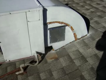

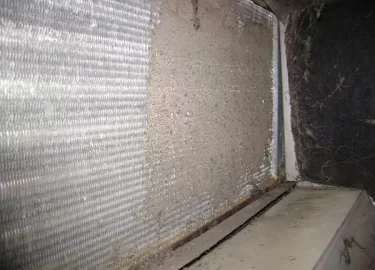

I cut access panel to get to input side of indoor condenser. It hasn't been cleaned in 30years.
Condenser left side cleaned with brush attachment on hand held vacuum.
Right side not cleaned yet.

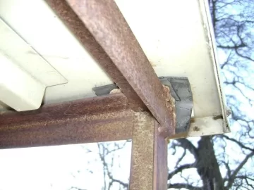

Rubber under units to cut down vibration to house.
