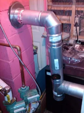

I have my Avalon Astoria 45k BTU stove rated for 2,200 SqFt also going into a Masonry Chimney in my Basement. The chimney has a 8x8 flue with a clay flue liner. However before I used it I did a few hours of research and talked to quite a few people because from what I understand, the chimney can be too high for a pellet stove which likes only 5 foot high pellet pipe. So finally on the web I found something that said it should not be more that 25 - 30 feet. My chimney is about that high from the basement and I finally talked to a pellet stove salesman that also had his hooked up to a chimney of the same height. This finally made me at ease about the whole issue and I bought my Avalon with the 4" flue and got a 8 - 4 inch adapter to hook into the same spot as my old Extra Large Vermont Castings Consolidated Dutch West Federal Design Wood/Coal stove!
So the end result is that it works great! It heats the whole 2,000 sq ft house upstairs and down in the basement with ease usually on a heat setting of 3 or less out of 6.
If the masonry chimney is taller or wider, then there may be a problem and maybe a metal flue liner is needed. As a matter of fact, I was just watching Holmes on Holmes last night and the wood fireplace had a problem where the smoke backed up and came out into the room! The problem was the irregular stone flue with jagged edges inside that kept the smoke from properly evacuating. The solution was a metal flue liner!!! That Mike make it right is great! LOL
Well hope this info is of some help and good luck. I am sure you will find the issue and it may be very obvious like a big open window!
See pic of my pellet flue behind my Taco 007 cartridge circulators that do not get used much any more!!
