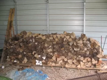

I'm going to try and attach a photo of some wood (already split) that my neighbor gave to me. He doesn't burn wood and this is from some trees he cut down...get this.. 5 to 6 years ago. He kept it covered so for the most part it is in good shape. It is probably 90% red oak. What you see in the photo is what I have moved to my place so far which is probably 2/3 of the total pile. I don't know what it would it would amount to in measuring by the cord. Here in southside Virginia wood is sold by the pick up truck load and usually runs $50 a load.

Good score on your neighbours wood. Free wood burns the best. And it sounds like it's well seasoned. If you're going to keep at the wood burning game, get a cheap wood moisture meter - they go for about $20 on E-bay and have 2 or 4 metal prongs that you can poke into your wood. The meter should be able to measure at least 10-40% mositure. Use your ax and split open a piece and measure the fresh face of that split - aim for 20% or less moisture.
A cord is 4'x4'x8' = 128 cubic feet, stacked. If you get a stacked pick-up truck load well rounded it might be a half a cord. Don't be surprised if it isn't too well seasoned, and shows up at 30%+ on your meter. A moisture meter doesn't lie, and you need to season your wood for at least a year in most cases.
Your shed looks nice and dry. I see you are using pallets to stack on - a lot of us do that.
