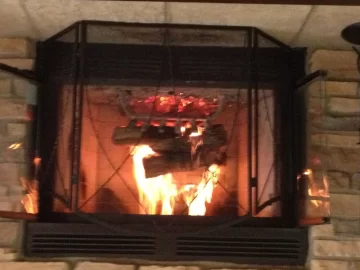

Hello,
My name is Dan Maldonado. I currently have a superior bc42 (broken link removed) that came installed in my home and want to upgrade to a high efficiency fireplace. I have over 6 cords of wood that will be used to heat our 2000 sq ft home. It is tightly insulated (r60 blown in attic insulation), well sealed, and I can maintain or heat the home with the terrible fireplace I have right now. I want to heat the home with the fireplace, so any advice anyone can give on an efficient fireplace to heat my home would be greatly appreciated.

There are a number of different manufacturers of EPA-Rated Zero Clearance fireplaces out there, Dan, & most of them will do a really good job of heating that space. You may have to add some mechanical movement to reach the areas farthest from the appliance, tho. What you'll need to do is determine the area required for installation of a new unit versus what you have now for the existing ZC box. You may or may not be able to squeeze a new one into that same space. I have done a number of tear-outs & if your existing box is an internal install, replacement can get tricky. Sometimes you have no option but to "steal" space from an adjoining room to get the new one to look good. If your install is on an external wall, the space is already there & just needs to be framed in, insulated & sided. Refer to an owner's manual for the existing unit & then go on-line for manuals for the EPA-Rated units & compare the install requirements. You may have to take the existing chimney height into consideration as well as the floor space. Once you've decided on one or two models, report back & ask your install questions. You'll find the answers here.
It is an external wall. The picture I have is too large to display of the fireplace. Hopefully, I can install a zero clearance unit in there. I am interested in the Napoleon ( (broken link removed to http://www.napoleonfireplaces.com/category/furnaces/wood-fireplaces/) ) EPA zero clearance, osburn ( (broken link removed to http://www.osburn-mfg.com/en/heaters/model-OB04001-description) ), or regency
( http://www.regency-fire.com/Products/Wood/Wood-Fireplaces.aspx ) Any thoughts on these would be greatly appreciated.
Thanks!
