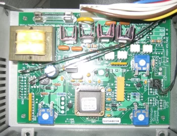

What's a potentiometer?
It's an electronic component which has a variable resistance. It's made of a wire wound around a core with an electronic contact that slides across the wire. The knob on the front side of the control panel is mounted to the slider of the potentiometer. In the photo it's the blue squares mounted to the board.

When you turn the stove off, the status light goes off. Does this happen for you? If not, keep turning the knob further down (towards stove/constant mode) until the status light goes out. If this happens, I would use compressed air on the contact clean to clean behind the board. Or you would have to remember the position of the knob to where it will turn off.
If the status light goes out when you are directly near off, then I would suggest cleaning the ESP probe.
Reactions: rona
Clean the esp if you haven't already. They can get cruddy and cause wonky things to happen.
They go bad every now and then, so I wouldn't be suprised if you need a new one.
The pots can cause problems too, but I would start with the esp.
