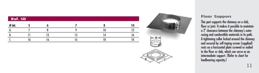

That is a roof support system. Can it also be used on the bottom end? Won't there need to be a firestop there, and at each floor penetration? I'm wondering if Security's floor support would be a better solution?

  • Help with class A
Yup, I verified with Metalbestos and they sent me documentation that the roof support can be used in this manner. You use a metalbestos trim collar on the ceiling side and a firestop at the top side.
