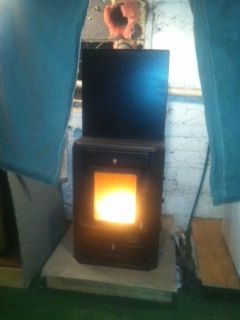

    I made mine...what stove do you have? I have a St Croix Pepin in the pic here and that's a 19Wx9Dx19H Just a rectangular box made out of 20gauge sheet metal, with a 1'' lip on the top and bottom. To fasten to the stove and for the lid to rest on. And i made the lid 3/4'' bigger on the front so i can open it.
    You can get away with 16'' high I neglected to measure a bag before i made it. Any questions don't hesitate to reach out be glad to help in anyway i can.

    To be honest I am not sure the pellet community smiles upon the hopper extension idea, I weighted my risks and took what I thought to be a logical approach. I drilled a bunch of holes on the back side of the extension to release any "extra heat" that might build up, but I measured the heat at the center of the pellets with and with out extension and the differential was minimal.

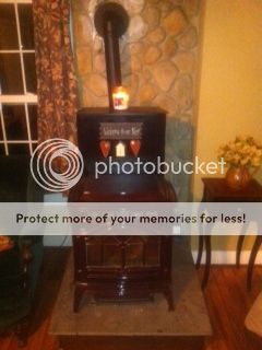

    I used 20 gauge sheet metal... Quad and St Croix.

    Mine is screwed down to the stove and i left the lid open inside the hopper extension.
