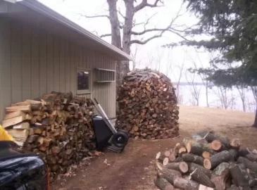

    German holz hausen (wood houses) or holz haufen (wood heap) method of stacking wood.
    Location: Near Poland and Lithuania.
    Size: Big one! Looks like about a 10 foot diameter.
    Source: Public domain photo from Internet.
    Add a photo of your own holz hausen or holz haufen to this thread (if you feel like it).

    Interesting, but I think the guy is optimistic about how much wood he's got there. Long splits, but looks closer to 1.5 cords to me.

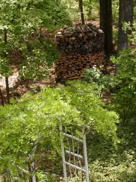

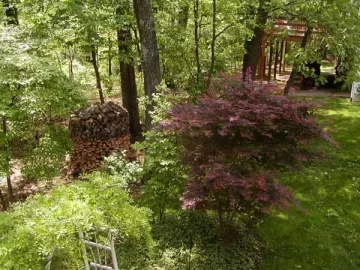

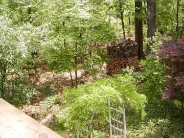

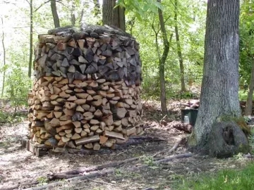

    I had the itch and finally scratched it. I've included a pic of my first holz hausen (or holz haufen).
    Todd, I appreciate you sharing your pics and technique. They got me interested enough to build one. As a side note of moderate interest, when Mother Mo Heat first laid her eyes on the completed structure, she actually gasped and said, "It looks just like a little house!" Seemed like a big coincidence after earlier discussions of whether the correct term was holz hausen or holz haufen. Maybe both are correct.
    Some comments regarding my holz hausen. :)
    It's built on a hillside so it's taller on the lower side and overall, a bit shorter than Todd's.
    It's about 7 feet wide and 6.5 feet tall. I needed a step ladder for the top, none-the-less.
    My center post (a cheap 1 x 2) was warped, so my stack got a little squirrely in places (asymmetrical circle).
    I didn't account for my wood well, so I can only guess it contains about 2 cords.
    The bottom half is fresh cut wood, the top half is year-old wood.
    It took longer to build, and required more artistry in stacking, than I anticipated.
    The foundation is of limbs laid cross ways with others laid around the perimeter (no splits touch the ground).
    Note the landscape timber on the lower hillside with three stakes for stability.
    My next holz hausen should be a bit easier to build. I learned a lot.
    Building the top half went much faster than building the foundation of random limbs and the bottom half.
    I may make the next one a bit wider and taller. I think lesser angles will be easier to stack.
    I won't use full splits as stringers next time like I did on one of the bottom courses. Smaller stringers are less distracting.
    Six inch half rounds make great shingles for the top.
    I feel like I've created a work of Yard Art. :)
    It looks ogranic. As though it grew out there. More pleasing to the eye than the wood rows it replaced.
    So far, everyone that's seen it, loves it. Mrs. Mo Heat thinks it looks like a giant pine cone.

    Here's a couple more photos...
    The guy is my brother-in-law. For reference, he's 6'2" tall. 6'3" with his shoes on.
