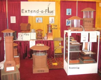

    My goodness, doesn't anyone follow my new products/inventions?
    Chances are good that this is happening because smoke comes out one flue and goes down the other. The solution:
    Raise the fireplace flue as per the recomendations of the Masonry Institute!
    See:
    http://www.extendacap.com for problem and solution.
    Also, if they want a nice looking solution, the Proper Topper does it in style:
    http://www.extendaflue.com/pt.html (see model with copper base)
    In most cases, chimney sweeps do one of two things:
    1. Install chimney caps, which actually make the problem worse! A multi-flue cap practically begs for this problem!
    2. Suggest a very expensive solutions - thousands of $$ to line one or both chimneys...problem will still happen.
    Sure, one can argue that in 1 out of 20 of these there is some other problem, like a breach between the flues....but I have sold a lot of these Boosters this year and the problem is fixed every time.
    Picture enclosed shows my booth at sweep convention - see the display at the right for what I am talking about.

    Yes, negative pressure can be made worse by a dryer, etc. - but exterior masonry chimneys tend to do it even with none of these factors present, so fixing this by introducing make-up air will usually not solve the problem....perhaps if one spent many thousands on air to air heat exchangers, etc. you might do it - but no one will do this....
    So, the simple solution that most people are capable of is to raise the upstairs fireplace flue.
    The amount of smoke it takes to smell up the downstairs is so little that is is possible you will not see the clues except in the most severe cases.

    Nice bird cages Craig.
    Just kidding sounds like you do I good business selling those. After becoming informed about chimneys and the like I can't believe the number of homes I see that have no caps at all on the chimney. its seems one could get all kinds of unwelcome critters and objects down there.
