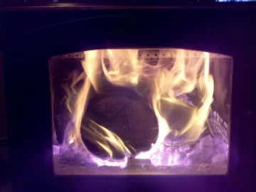

I have been playing around with some rounds....real dry ones.....here is a pic....it took off on a good coal bed...along with an Envi brick and some miscellaneous pcs...I set the end of it on the doghouse lip..

I don't burn a big round unless im certain it is very dry. My NC30 loves rounds and I load it with biggest round that will fit such that the end of the round lays just over the front lip. This lets the doghouse air jet get under the length of the round.
Then fir smaller splits all around it - or better yet- a couple ECO BRICKS.
IF your round is not dry then all you get is a brown spot on the window where the end of the round comes close to it.
Gotta be dry.
