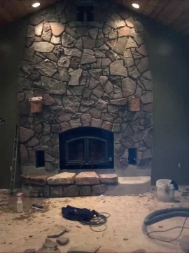

    Now hanging stone veneer is a tad harder....this is what I'm into right now....
    No I am NOT a professional. Yes I AM crazy......
