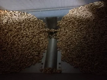

    Please post pictures of your burn pot and tell me about how well the area at the top of the auger flight inside the hoppers looks, pictures even bettter.

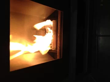

    Here is a pic of the auger (I think this is what you want) and the burn pot when it fills it actually goes up the chute and we have had a fire in the chute and behind the wall. Is this what you want?

    Is there any space around the burn pot as it sits in the liner...paying close attention to the front and sides.
  6. Newpelletpig New Member
    joined: Dec 17, 2012
    6 posts
    S. Sutton, NH
    a little wiggle room, but not much, Is that what you mean?
  7. IHATEPROPANE Minister of Fire
    joined: Feb 24, 2011
    800 posts
    Southern,MA
    Yes....if there is any space around the pot try wedging a little rope gasket in there to see if it burns better. I originally had some pile ups when I first for mine ....this and a few things Smokey pointed out fixed it dramatically. Now I almost have too much air and almost never have any buildup at all. And if I do I give it a quick stir and its good again for a while. I permanently put rope gasket around the whole pot. This works nice....although I am not sure how long it will last before replacing. I really wish they would weld a lip around these post like you see on other brands.

    That area where the small pellet bunch is in the picture of the hopper where the auger flight cover ends is also a place that shouldn't have any gap.
    If there is a gap there as the pellets get used up and the level drops below that spot you'll get an air leak there. I'd use a small piece of flat stove window glass gasket to seal that area with.
    As IHATEPROPANE has already mentioned you want to place some stove rope gasket under the rim of that burn pot. It should be a bit larger than the depth of the rim, this should allow it to just sit under the rim with out needing any thing except pressure to hold it there. This gasket section will partially seal off the top row of air holes and any gap between the rim and the burn pot. Sealing the rim will remove one burn pot air bypass, and partially sealing the top row of holes wil remove a substantial portion of another burn pot air bypass.
    By doing this sealing a lot more air will be going through the bottom of the burn pot and thus the pile of burning pellets. This provides a lot more air flow to also eject fly ash instead of it piling up in the burn pot and subsequently warping the pot and creating giant clinkers.
    There may also be other places that might need some RTV sealant, the primary one I'm aware of is where the auger flight on the underside of the hopper meets the drop chute, there is a metal flange there that sometimes isn't gas tight.
