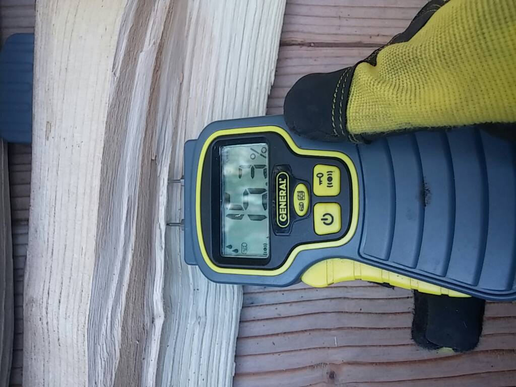

This was a reading from wood in my wood shed since last July. I split 4 pieces and got the same readings. I don't trust moisture meters

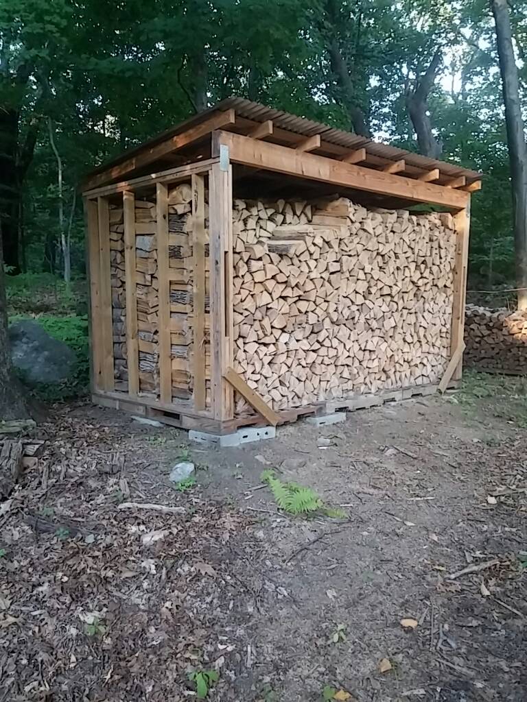

Took it from the top row....has been in the sun alot
That's exactly the same MM as I have. I did the palm thing reading these posts and mine was 30.2. I'm guessing I/we need some more seasoning! !!!

Up at the top of a covered woodshed, ash, 12+ months, that doesn't surprise me one bit. It would surprise me if the splits on the bottom were as dry. I started stacking mine right up to the metal roof after I discovered this phenomenon. I wish my shed was all roof... Everything up there is probably golden.
A year and 2 months.....ash
That seems right to me. I split some Ash in late July last year and my MM (same as yours) had it between 19 and 21% in November. It was split small and stacked loosely in a favorable area but Ash dries quickly in my experience. BTW... Great stack!
Yep. Last year I thought I had a stack of 18% oak in only 1 year. Turns out the top two courses were but as you picked down it got much much higher!

I got the same meter, I had some cherry last year that was split and stacked for (3) years, it registered 11%, I thought the meter was playing games until I through the splits in my old stove, It was like burning newspaper. I also with the same meter hit some oak that was (2) years old and it kept registering 26%, I thought it was high, I threw a couple splits and had the boiling steam effect come out the end grain. I trust my meter.
The key to using it properly is just like in your photo, fresh split face, find the grain length and put the probes in parallel.
