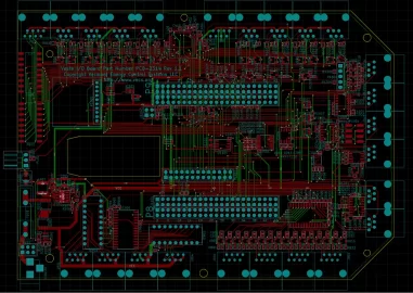

I've had the Vesta software running on a RasPi, but I never wrote any hardware I/O handlers for that platform. We now use the Beaglebone Black as the compute engine. Unfortunately, the I/O is pretty fragile and limited, so I had to design a board to provide ruggedized I/O in sufficient types and quantities. When it's all done, the Beaglebone is a pretty small part of it. See the board layout below.
I might go WIFI control with boiler
I'm going to have to crawl very slowly to get back into this stuff. Are you sure that's not a Rembrandt rather than a photo?
That accursed board has almost 400 components on it. Routing it was a trip. We use one in a Vantage, and two in a Pro. It has 5.2V utility supply, protected 12V relay power supply, 5.000V reference supply, real-time clock, protected discrete inputs, high current discrete outputs, differential analog inputs, 4-20mA inputs, 4-20mA outputs, wireless sensor radio, 1 wire interface, RS-232, Modbus, pulse inputs, and a bunch of other miscellany.
