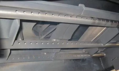

I am a relative newbie to the wood stove world, but due to an installation error by the shop, I am on my second Jotul 550. The shop did the right thing and replaced the stove, but as I built a break in fire now that the weather has started to cool, I noticed something different. I can see up the flue liner. From the looks of this picture, I think they installed the baffles, but forgot to pull the skamol panels into place (thank you manual for the terminology). Any confirmation is greatly appreciated. Sorry about the image size, it is all I could get under the attachment limit.

Hard to see in the tiny image, but it sounds like you are correct. You should not be able to look up the flue exit.

I was able to get a better picture sized up with different software. Hopefully this is easier to see. It appears to my untrained eye that they installed the baffles, but forgot to slide the skamol bricks (if they are bricks, I had a break-in fire going and was not about to reach up there - safety first). You can see what looks like the skamols resting on top of the baffles and hanging over the edge. I would think I should be able to reach up there once they are cooled and just pull them into place.

That's much better. Yes, the panels are missing from the center. Looks like they spaced this out. I see the panel overlap on the right. Reach up there and see if you can find the rest of them. If so, they should slide over and into place.
Are the panels on this model stove one piece or two? I know the Oslo and firelight have one piece panels but the flue exit is to the rear not like the 550 right over the top. Good catch on the shops mistake, however this is the second tme they have been out? I would not have much faith in your shop after the last mistake.
If you look closely on the left you can see the corner of the second one and from the manual it appears that there should be two. My faith in the shop is definitely limited.
