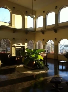

The home is 5000 sq-ft on a 3000 sq-ft basement. I know, way to big. It's a lake house with plans to attract the kids/grand kids back. There are two stories on the basement. It has a large open area to both levels 30' by 30'. All windows are triple pane with lots of glass to the South.

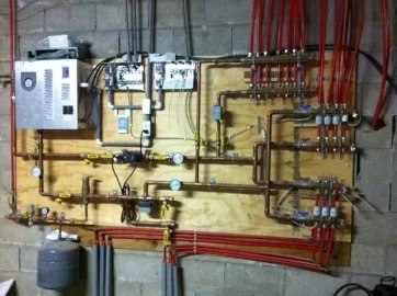

All the non basement floors are 4" slabs suspended, polyiso insulated from below. The floors have radiant tubes. There are 7 zones each with thermostats in air and slab. I had the system with zones to the guest rooms so they would be shut down during the off season. The radiant system was designed by NRT, an East coast design group. Good guys. The system has ele on demand boiler, with provisions for alternative heat source. I looked at solar as this source but IN is cloudy in the winter to often. So wood is the best solar energy here.

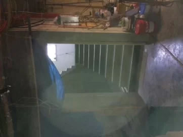

The radiant main manifold and control panel is located in the basement. The mechanical room is 16' by 16' with only other equipment in there is a water heater and air handeler. lots of room. Next to the mech room is the staircase and possible a good spot for storage. It is under a landing, size-> 5' by 5' by 11'.

Ok with my first post with so much. here are a few photos. Radiant panel, proposed storage under stair landing and the sun room
