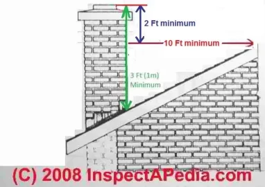

Unfortunately, my roof is a 12/12 or 45 degrees, which means I need a 12' tall chimney above the roof. (Right?)
No, not necessarily. The chimney just needs to stick through the roof 3' minimum, and also be 2' taller than any point in the roof within 10'
Ideas to Avoid Tall Chimney
This is correct. Your roof rises 10' over a 10' run. So in order to be 2' higher than any point within 10', your chimney will be at least 12' tall
Unless of course the roof peak occurs within that 10' or horizontal distance. Then you just need to be 2' over the peak.
